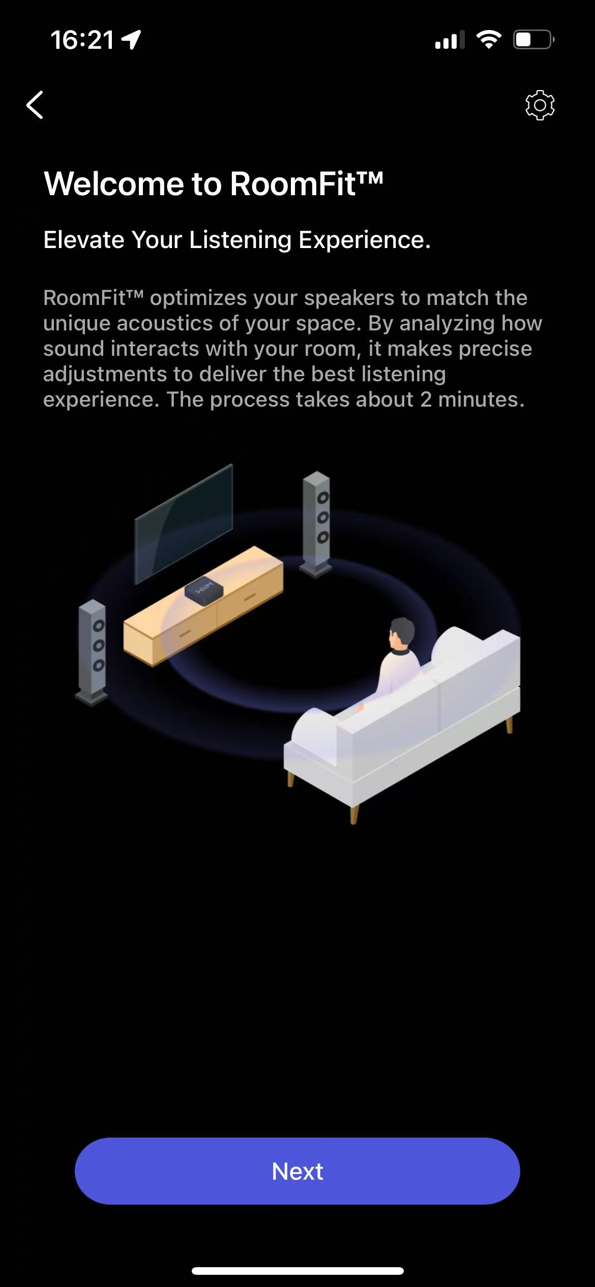

  1. Open the WiiM Home app.
  2. Go to the Devices tab and tap the Device Settings iconof your WiiM device.
  3. Select RoomFit™.

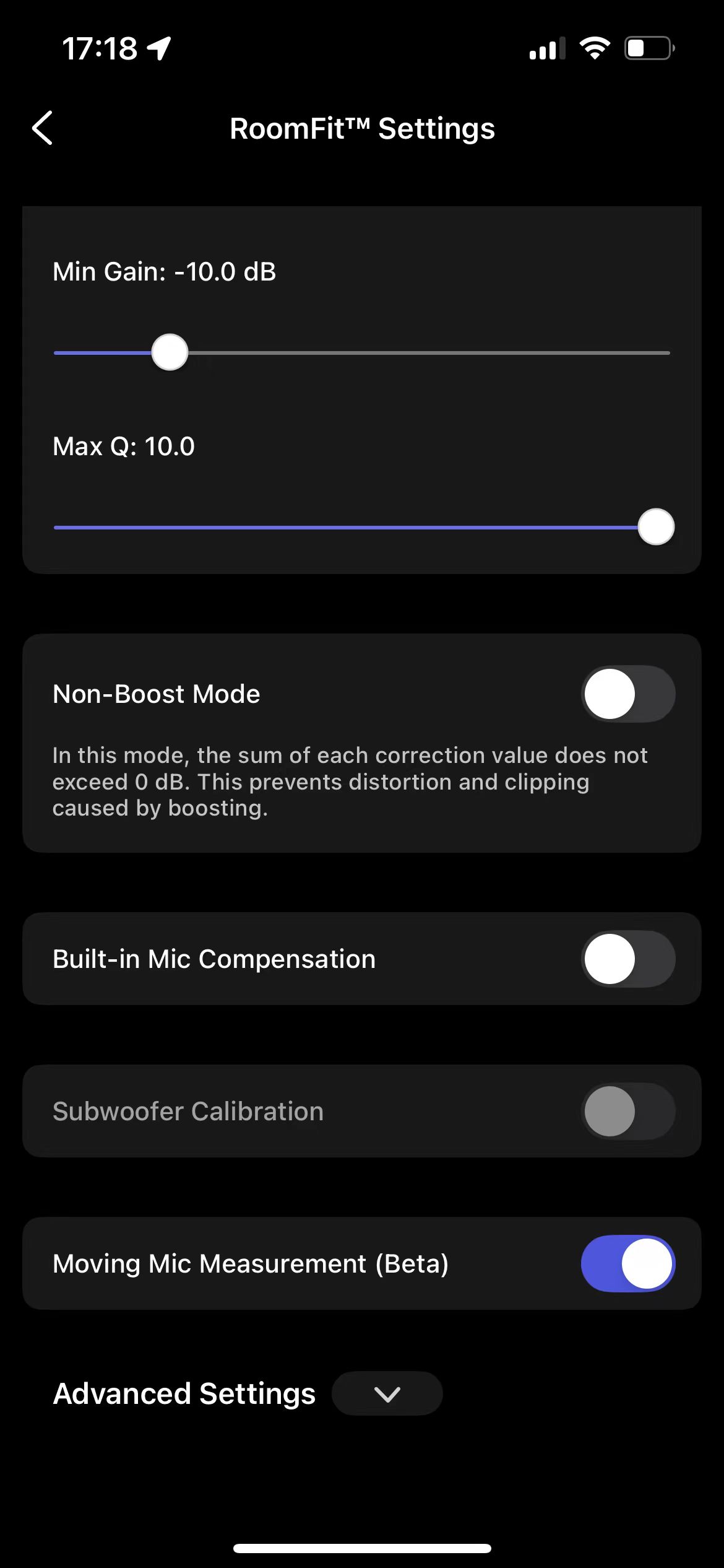

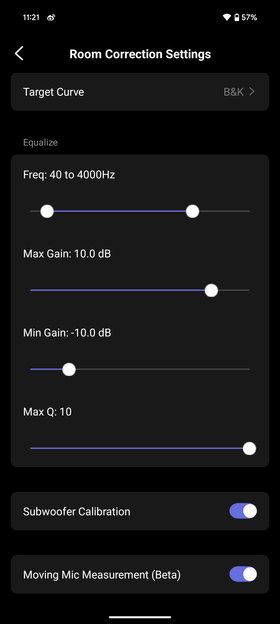

  4. Tap the RoomFit™ Settings iconin the top-right corner.
  5. Toggle on Moving Mic Measurement to enable the MMM calibration method.
    You can also adjust other settings as needed. For details, refer to
    Introducing RoomFit™ Settings.

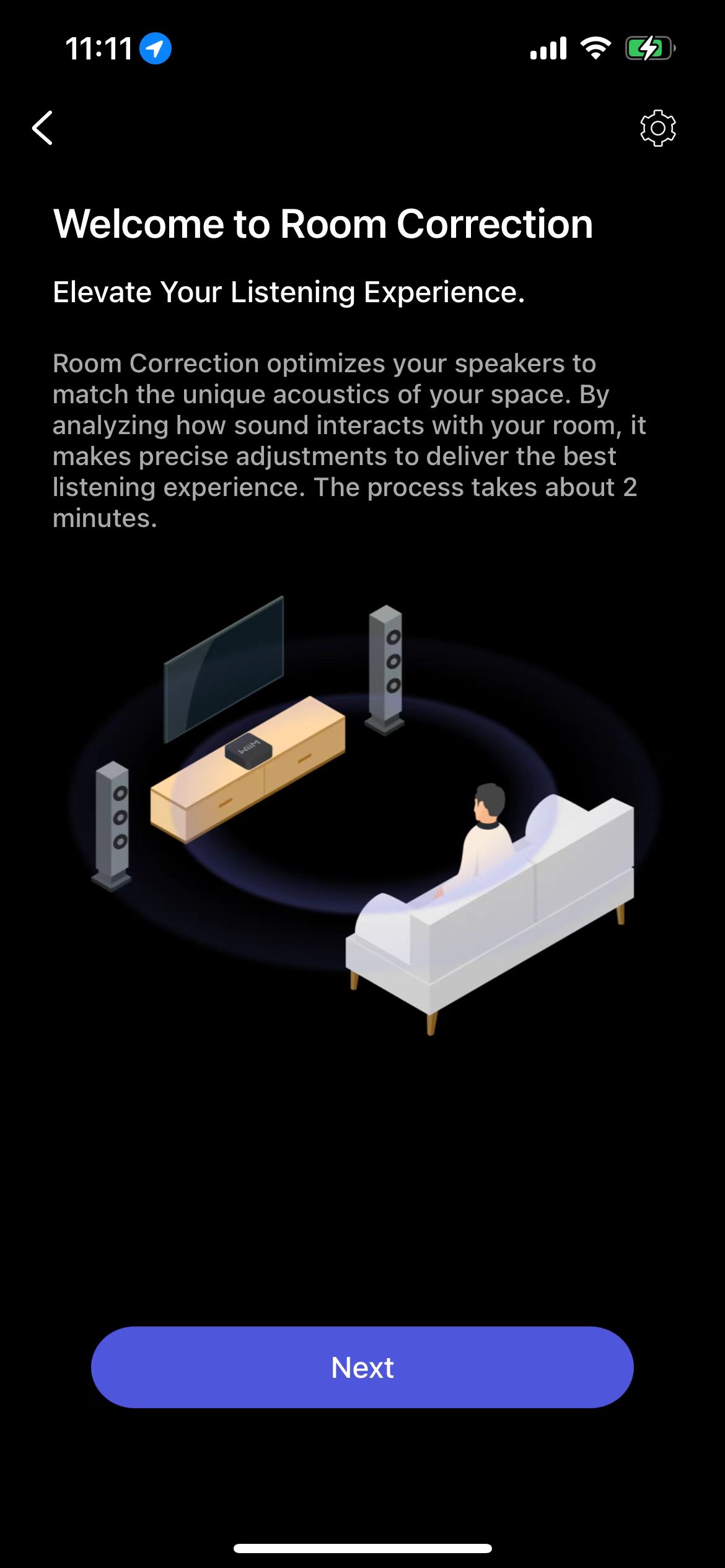

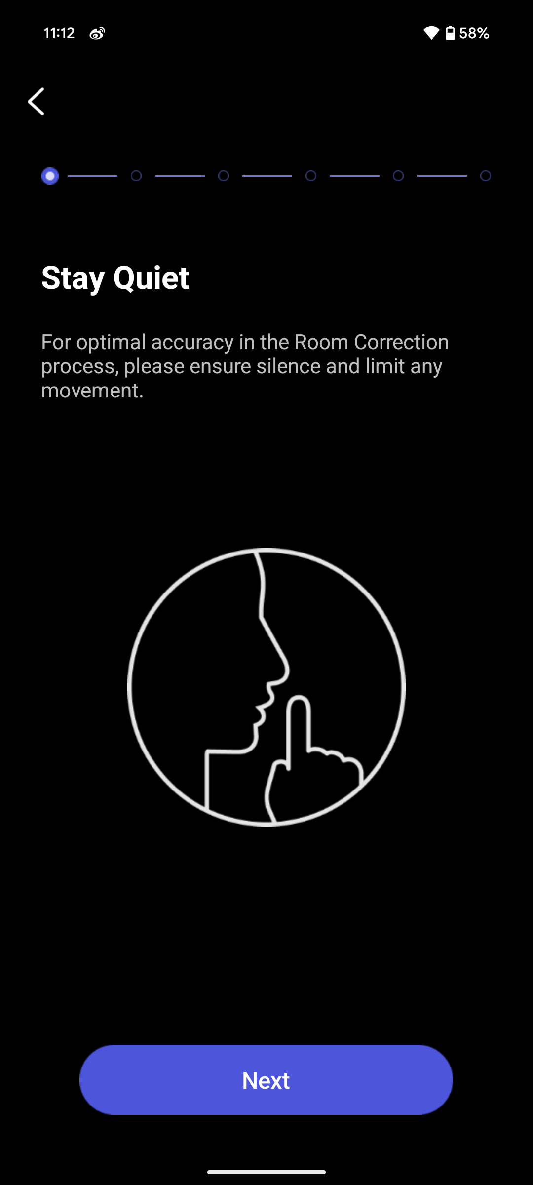

  6. Go back and follow on-screen instructions to complete the Room Correction process.
