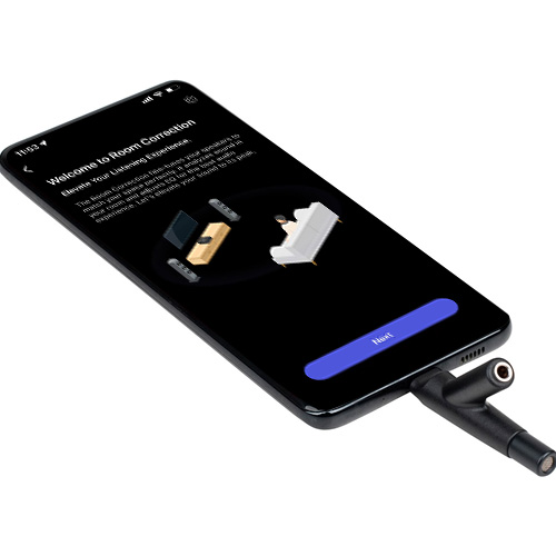

1. Connect the External Microphone
Plug your external microphone into your smartphone or tablet, usually via USB or headphone jack.
2. Launch the WiiM Home App
Open the WiiM Home app on your smartphone or tablet.
3. Import the Calibration File (if available)
If your microphone has a calibration file, download it from the manufacturer's website and save it on your device. Then, follow the instructions in Tutorial: Microphone Calibration File Import in WiiM Home to import the calibration file to the WiiM Home app.
4. Run the Room Correction Process
Start the Room Correction process in the WiiM Home app and follow the on-screen instructions to complete the process. The app will guide you through the steps to measure your room’s acoustics using the connected microphone.
