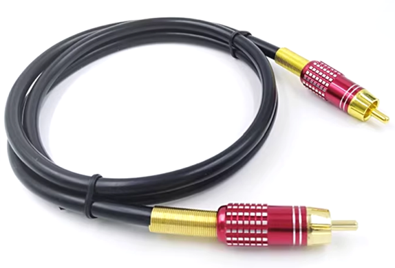

3. Check the Cable
Ensure that you use a RCA-to-RCA cable with a 75-ohm impedance to connect your subwoofer to your WiiM device.

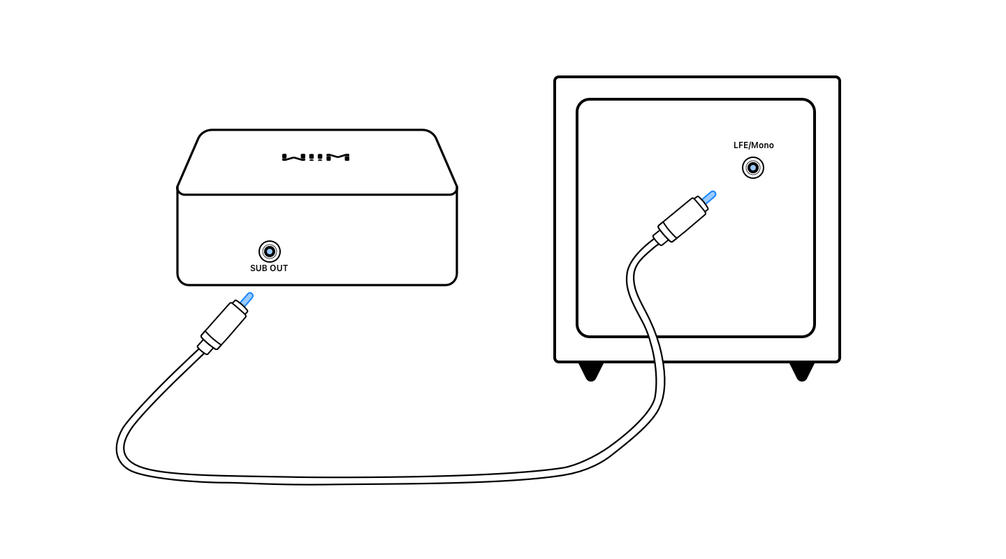

4. Check the Connection Ports
  • Ensure that one end of the RCA cable is connected to the Sub Out port on your WiiM device.
  • Ensure that the other end of the RCA is connected to the LFE or Mono port on your Subwoofer.
LFE (Low Level Input or Line Level Input) is a type of signal input that uses RCA (phono) cables. It is commonly used in home theater and Hi-Fi audio systems. This input is designed for low-level audio signals from sources like pre-amplifiers, AV receivers, or audio players. If your subwoofer supports LFE input, make sure to use it to connect to your WiiM device.
