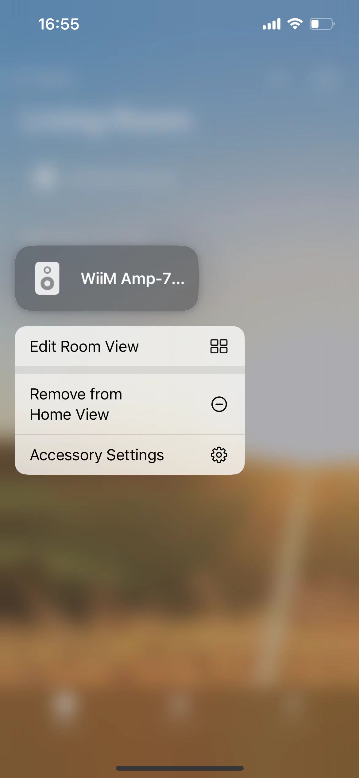

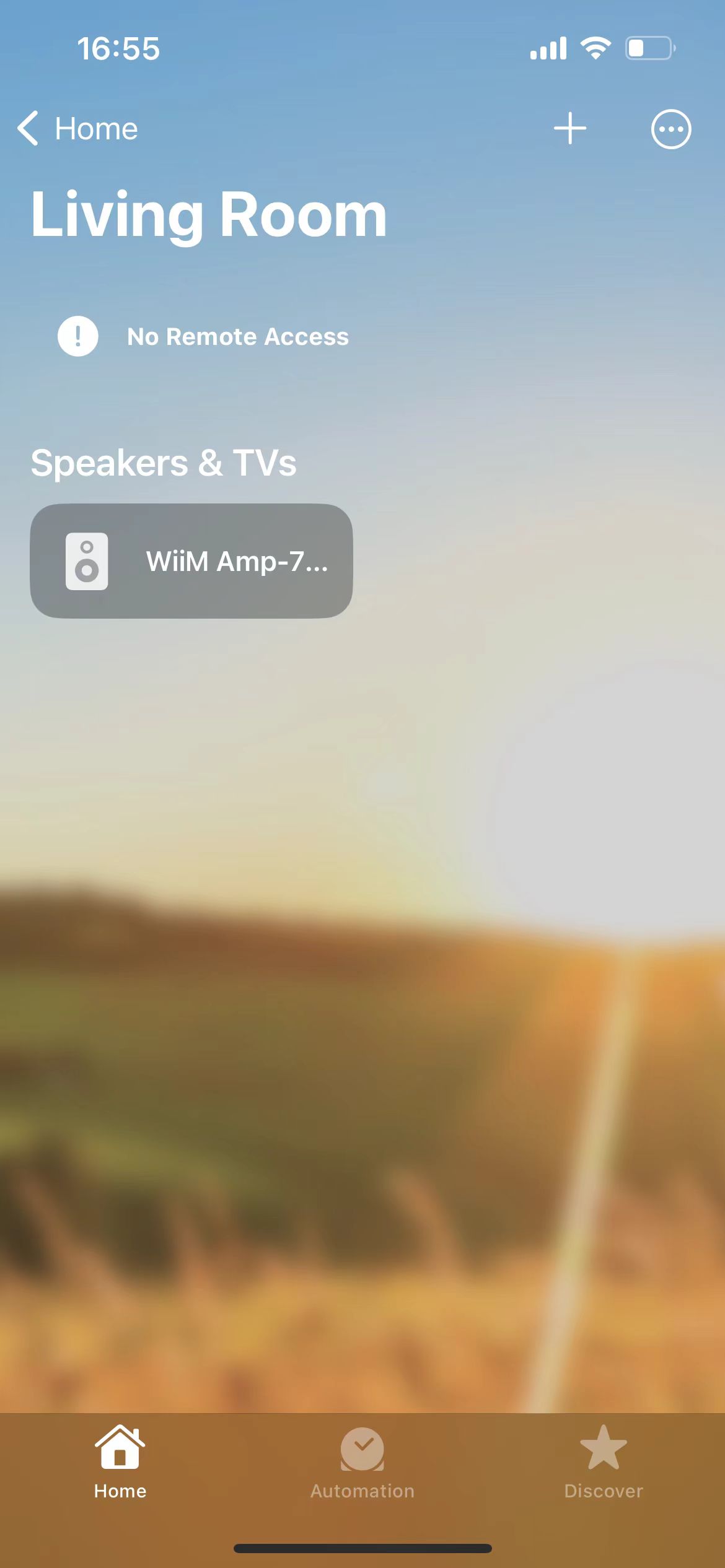

- Open the Home app on your iOS device.
- Locate your WiiM device in the Home app.

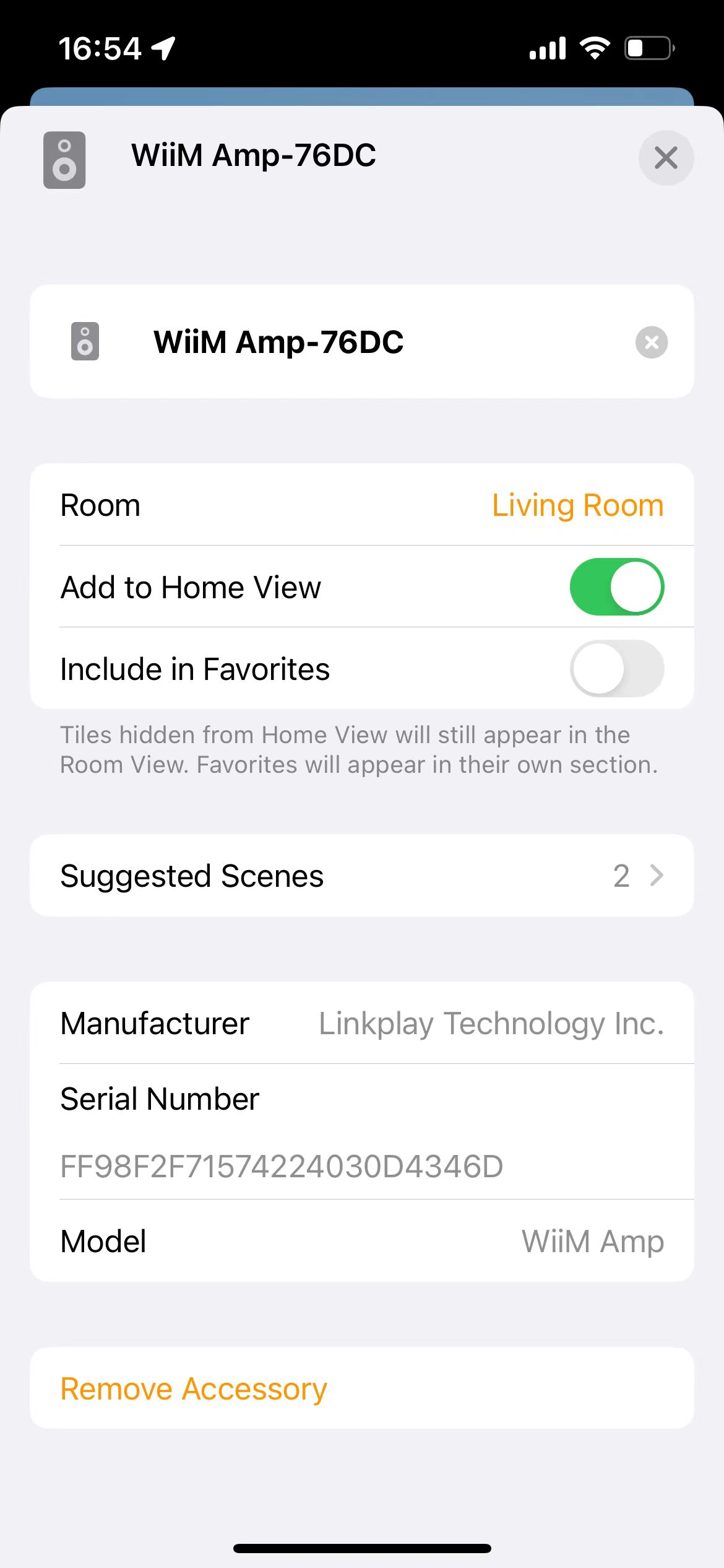

- Tap and hold the device icon, and then select Accessory Settings.

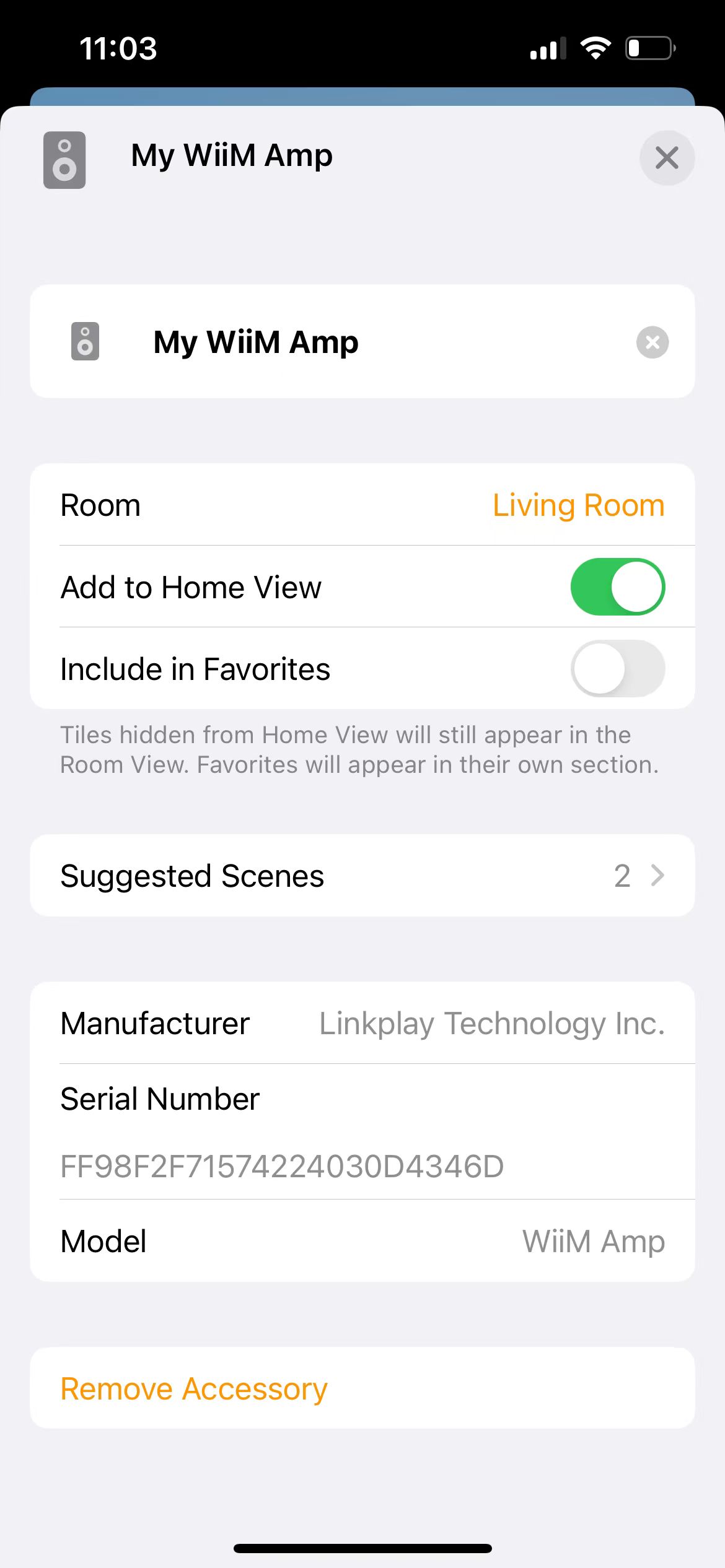

- Enter your preferred name for your WiiM device.
- Open the WiiM Home app to verify your WiiM device name. You should see the updated name.
