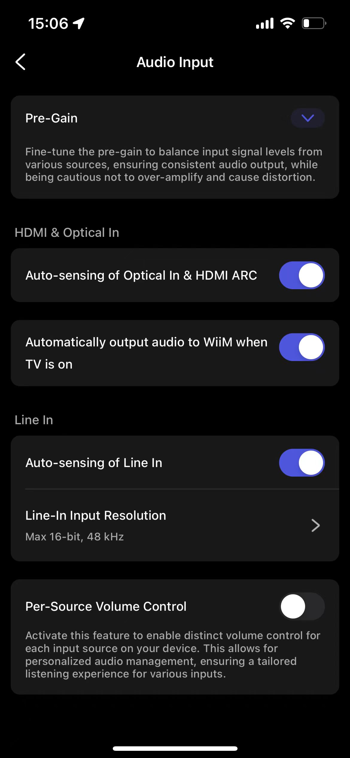

Automatically Output Audio to WiiM When TV is On
The WiiM provides a configuration option called 'Automatically output audio to WiiM when TV is on'. This option allows you to enable or disable the automatic switch of the WiiM device to HDMI ARC mode when the TV is powered on.

Configuration Instructions
Follow these steps to configure the 'Automatically output audio to WiiM when TV is on' option:
- Open the WiiM Home app.
 - Go to the Devices tab and tap the Device Settings icon
for your WiiM device. - Select Audio Input Settings.
 - Toggle on or off the 'Automatically output audio to WiiM when TV is on' option based on your preference.
