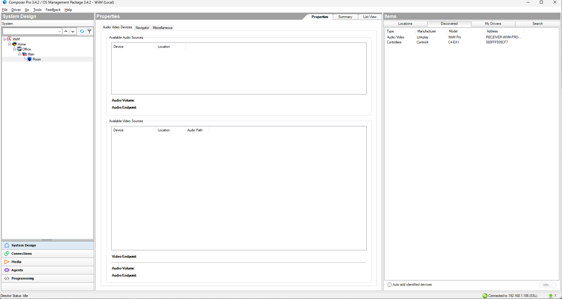

- Click the Discovered pane on the right, run a scan for new devices. Your WiiM device should appear as a network device.
- Double-click your WiiM device to assign it to the room in the Control4 system.

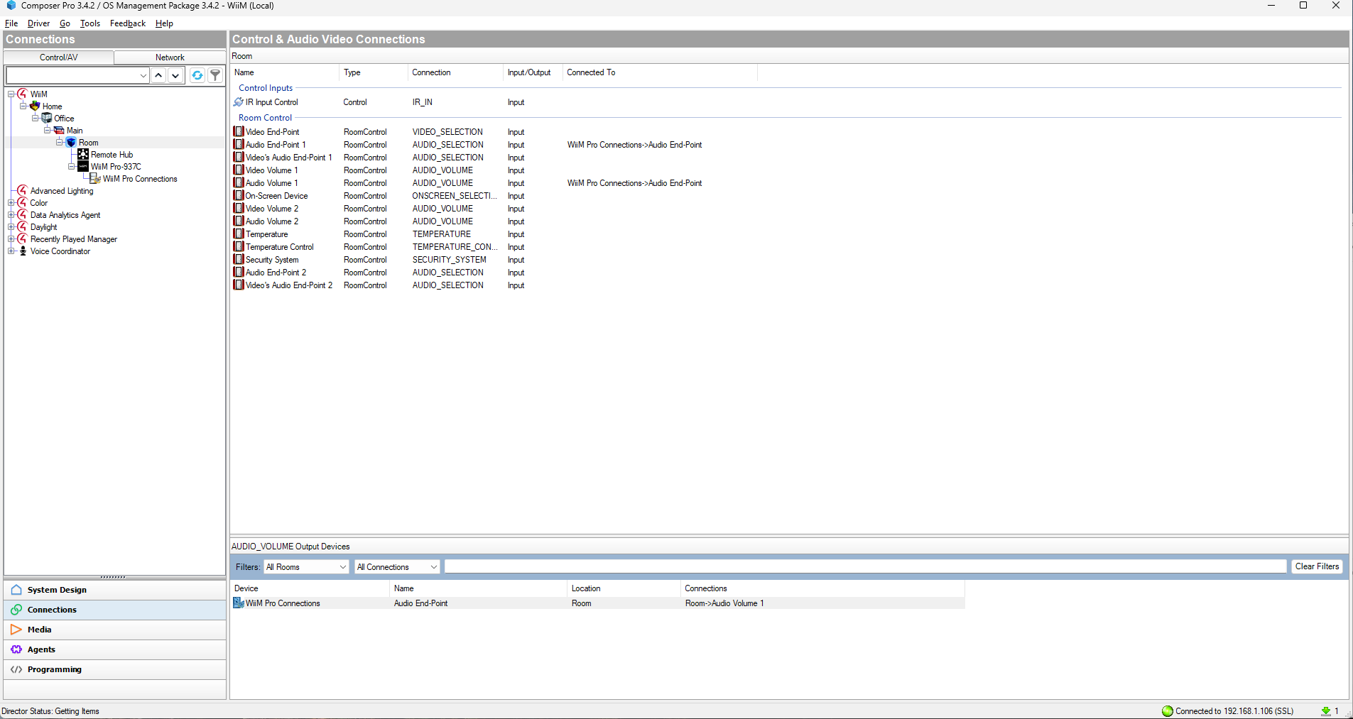

- Select the Connections tab on the left, drag and drop Audio End-Point 1 and Audio Volume 1 on your WiiM device listed in the bottom.
Now, your WiiM device is successfully added to the Control4 system.

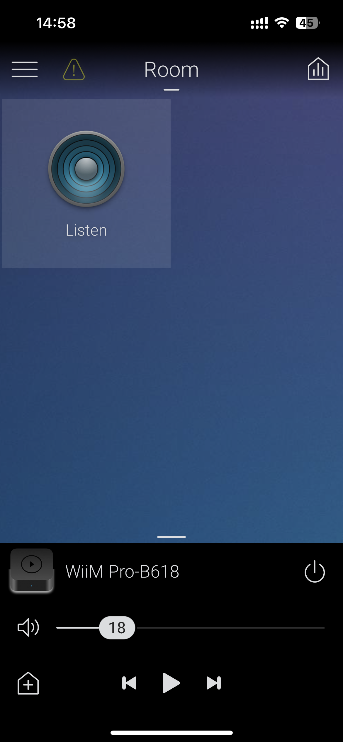

Playback Control
Once your WiiM device is successfully added to the Control4 system, start playing music on it. Then, open the Control4 app on your mobile device and go to the room where the WiiM device is added.
Here, you can control playback, including:
Play/Pause, skip to the next or previous track.
Adjust the volume.
Adjust shuffle and repeat mode.
- Tap
to group your WiiM devices. For details, see Group and Un-Group WiiM Devices.

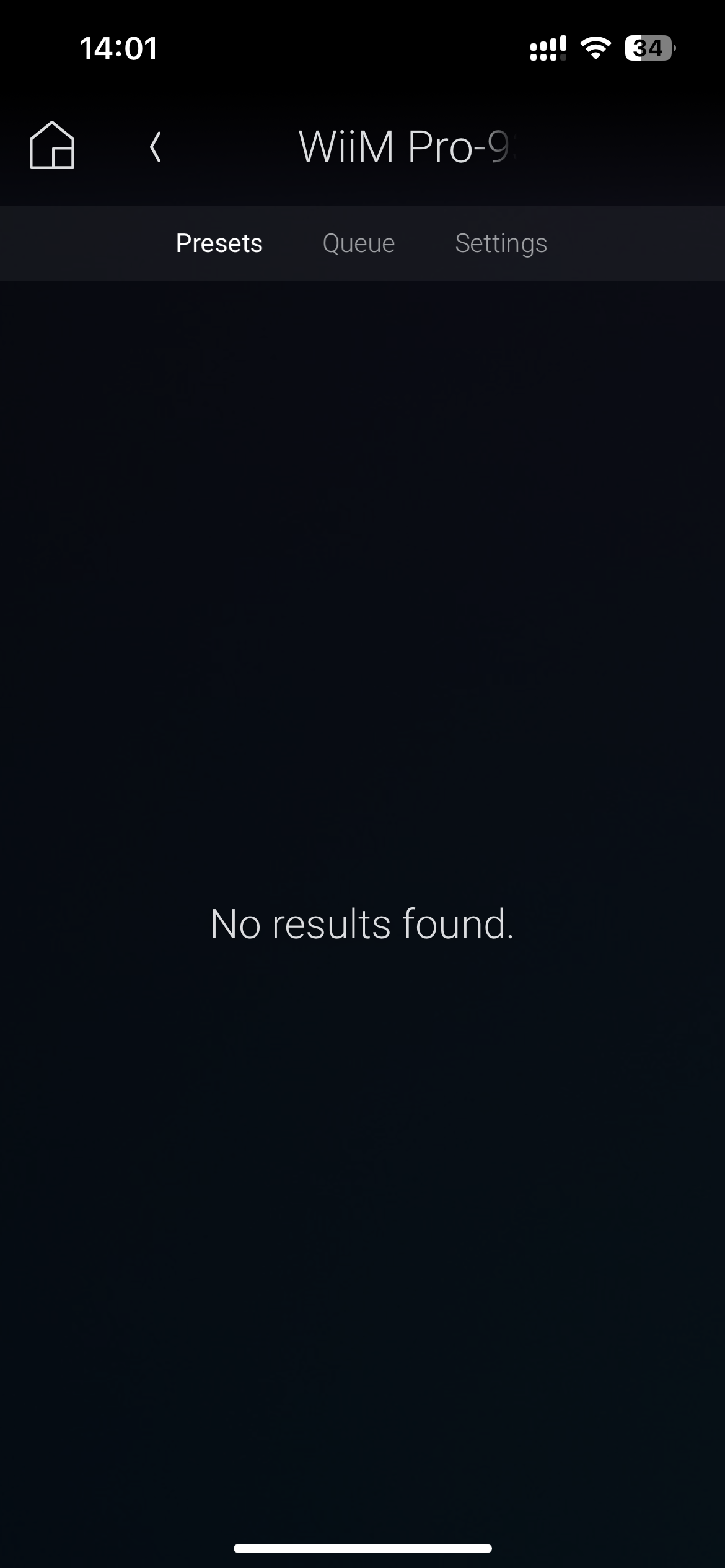

Tap the
icon to access the presets, playback queue, and adjust audio input/output settings.

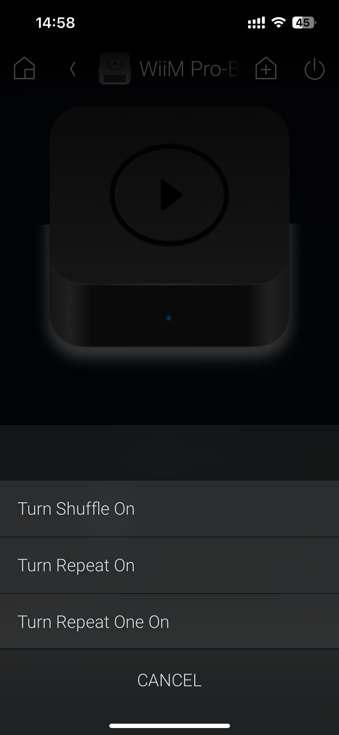

Tap
and then
to enable shuffle and repeat mode.

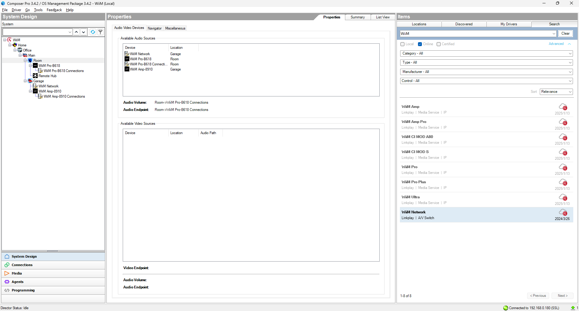

If you are using the group and ungroup functions in Control4 for the first time, you must add the WiiMNetwork.c4z driver to any one room before proceeding.
Click the Search pane on the right, search for "WiiM Network", then double-click the driver to add it to the selected room.

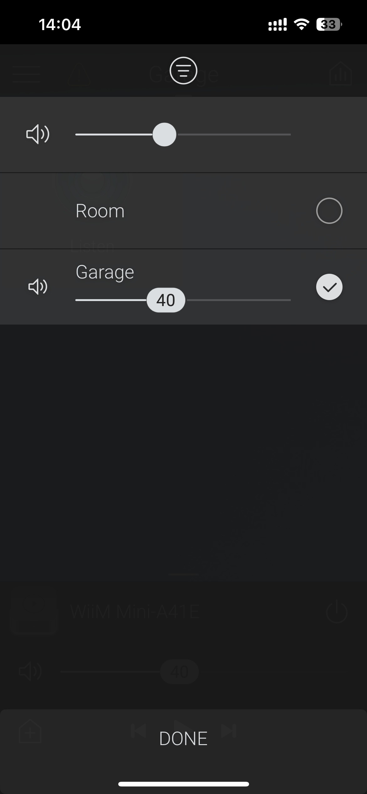

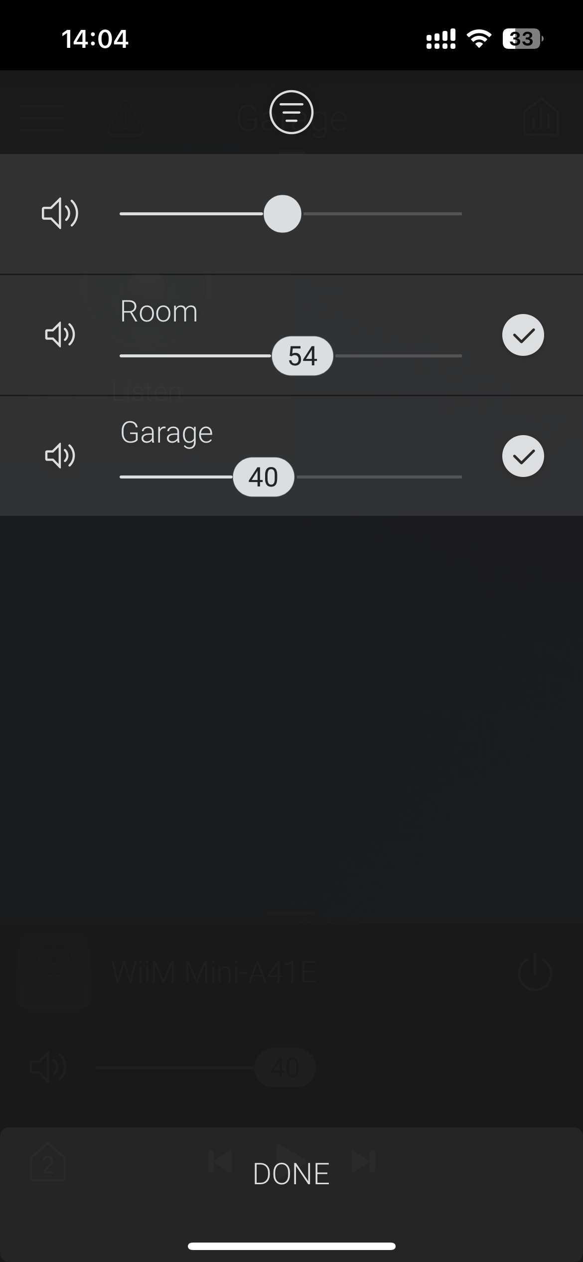

Group
To group WiiM devices, follow these steps:
- Tap the
icon.
- Select WiiM devices you want to group.
- Tap DONE to complete.
Un-Group
To ungroup WiiM devices, follow these steps:
Uncheck the devices you want to remove from the group.
