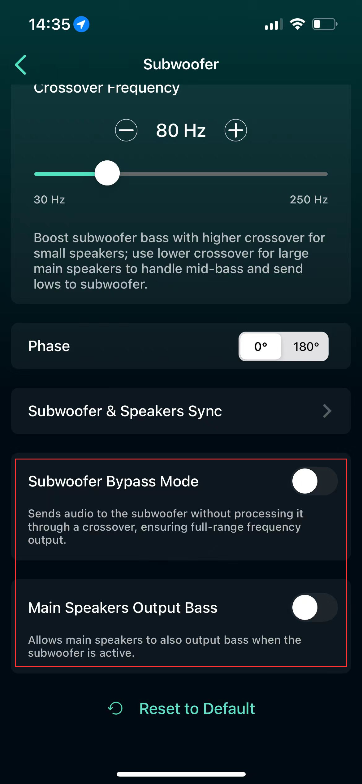

To provide greater flexibility, WiiM also offers two advanced subwoofer settings as follows:
- Subwoofer Bypass Mode
- Main Speakers Output Bass
These settings let you further adjust how audio is sent to the subwoofer and main speakers and help optimize system performance based on your listening environment and preferences.
When enabled, this option sends full-range frequency audio to the subwoofer, providing deeper and richer bass.
You can enable this option based on your listening environment and personal preferences. If your subwoofer does not produce sound, try enabling this setting to troubleshoot the issue.
When enabled, this option sends full-range frequency audio to the main speakers, ensuring that all frequency ranges are well represented and enhancing the overall fullness of your music.
If your main speakers have strong bass performance, try enabling this setting for a deeper sound.
