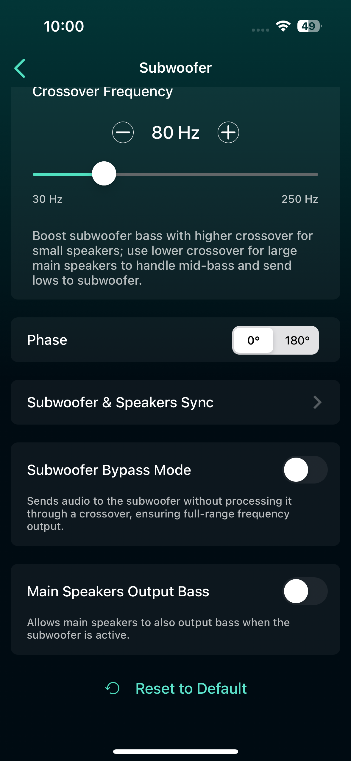

Go to the Device tab > Device Settings > Sub Out >Subwoofer & Speaker Sync in the WiiM Home app.
Then, choose Automatic Sync or Manual Sync to align your subwoofer and main speakers.

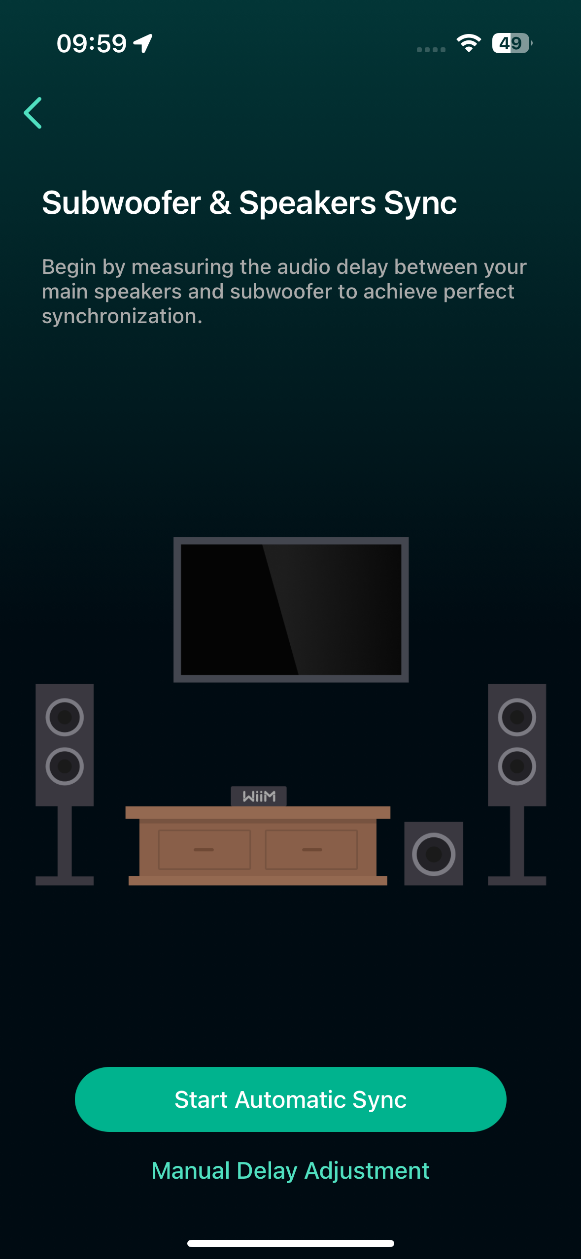

Automatic Sync Instructions
Best for: Most users seeking a quick, hassle-free setup.
How it works: Uses your phone's microphone to measure latency automatically.
  1. Select Start Automatic Sync.
  2. Prepare the Environment
    • Ensure the room is quiet
    • Rotate phone 180° (microphone pointing toward speakers)
    • Hold it at ear height.
    • Sit in the sweet spot.
  3. Audio Check: Tap Play Sound to ensure it's clearly audible.
  4. Start Measurement: Tap Start Measurement. Test tones will play from both speakers and subwoofer.
  5. Complete Sync: When "Sync Complete" appears, tap Done to apply the results.

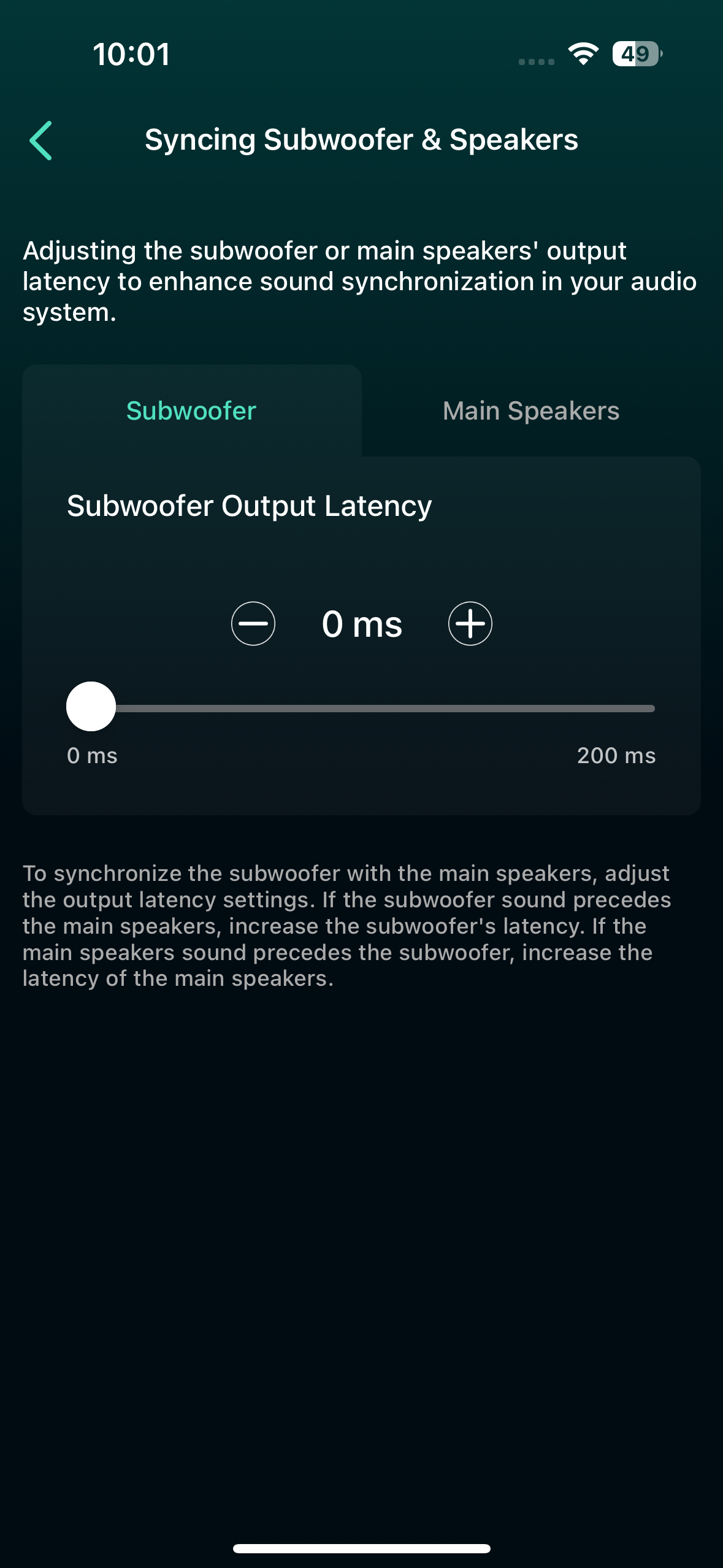

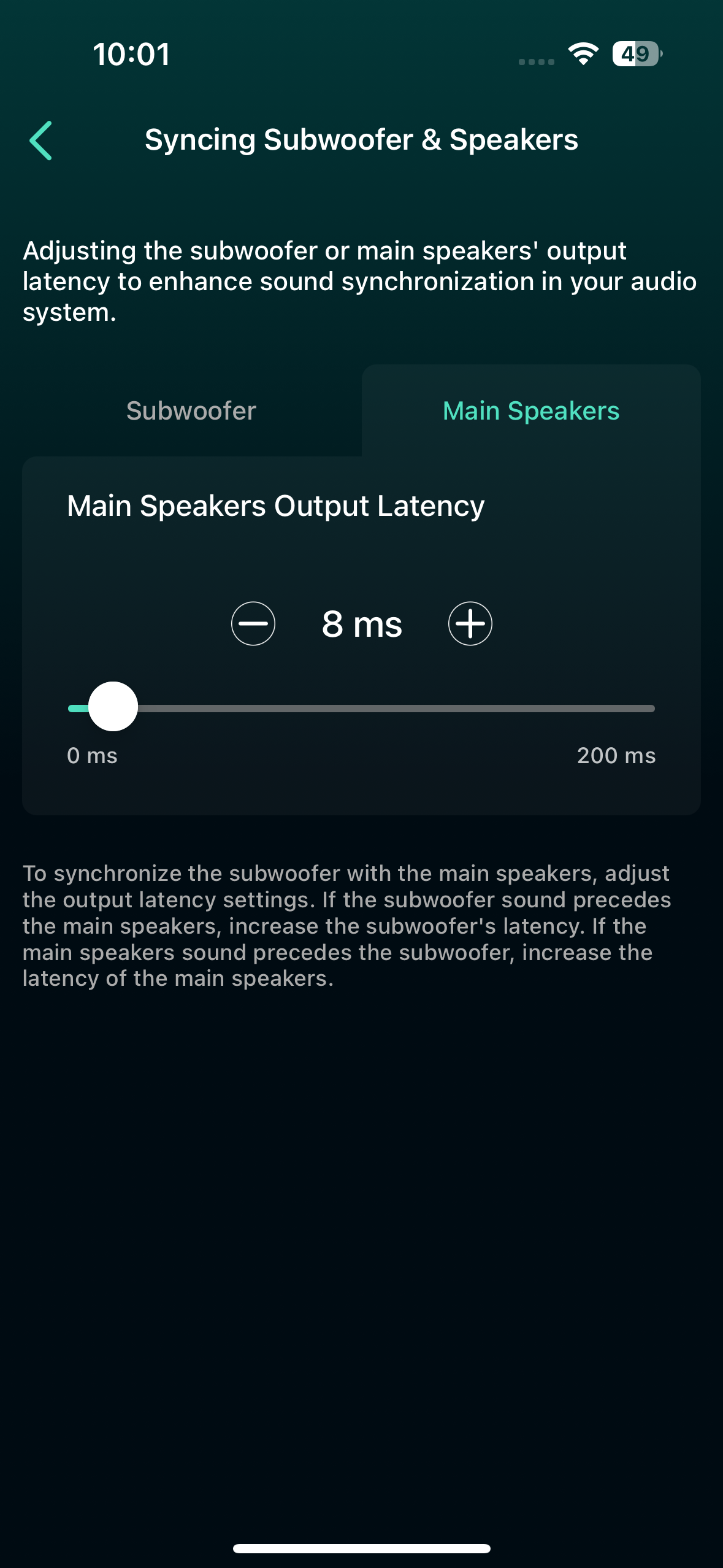

  1. Select Manual Delay Adjustment.
  2. Select Device: Choose the Subwoofer or Main Speakers tab.
  3. Adjust Latency: Use the slider or +/- buttons to set the delay (0 ms to 200 ms).
★ Tip:
  • If the subwoofer is too fast, increase its latency.
  • If the main speakers are too fast, increase their latency.
