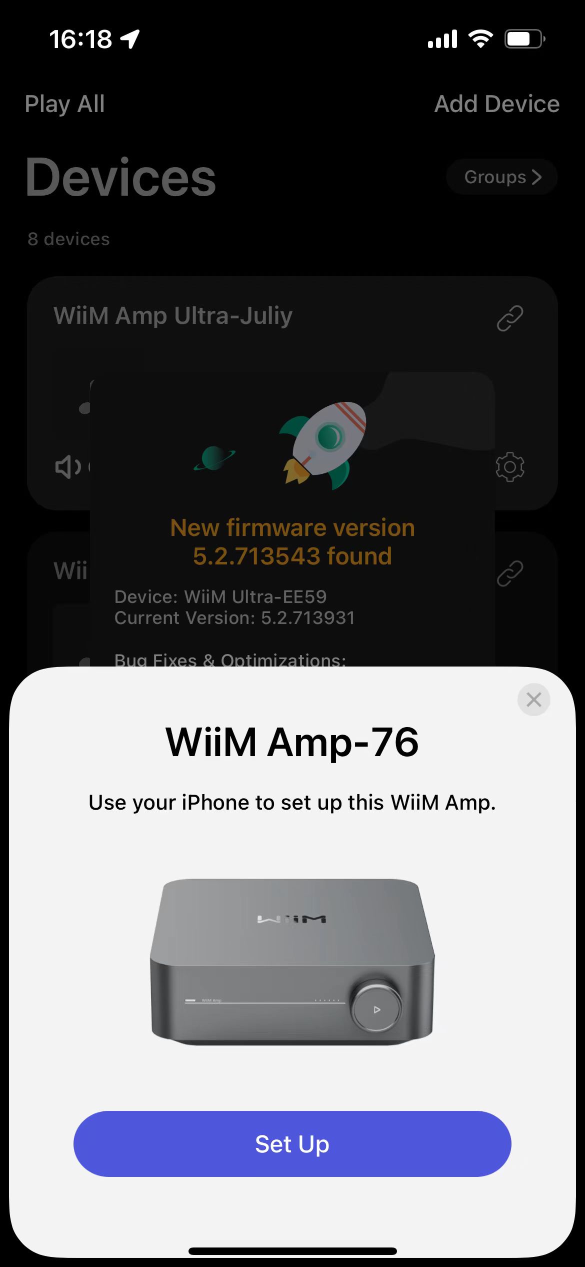

Note: Holding the Play button for 10 seconds will reset your device to factory settings, erasing all stored information. - Open the WiiM Home app on your mobile device.
- When the pop-up window appears, tap Set Up to continue.
- Follow on-screen instructions to set up a new Wi-Fi network and other settings.
