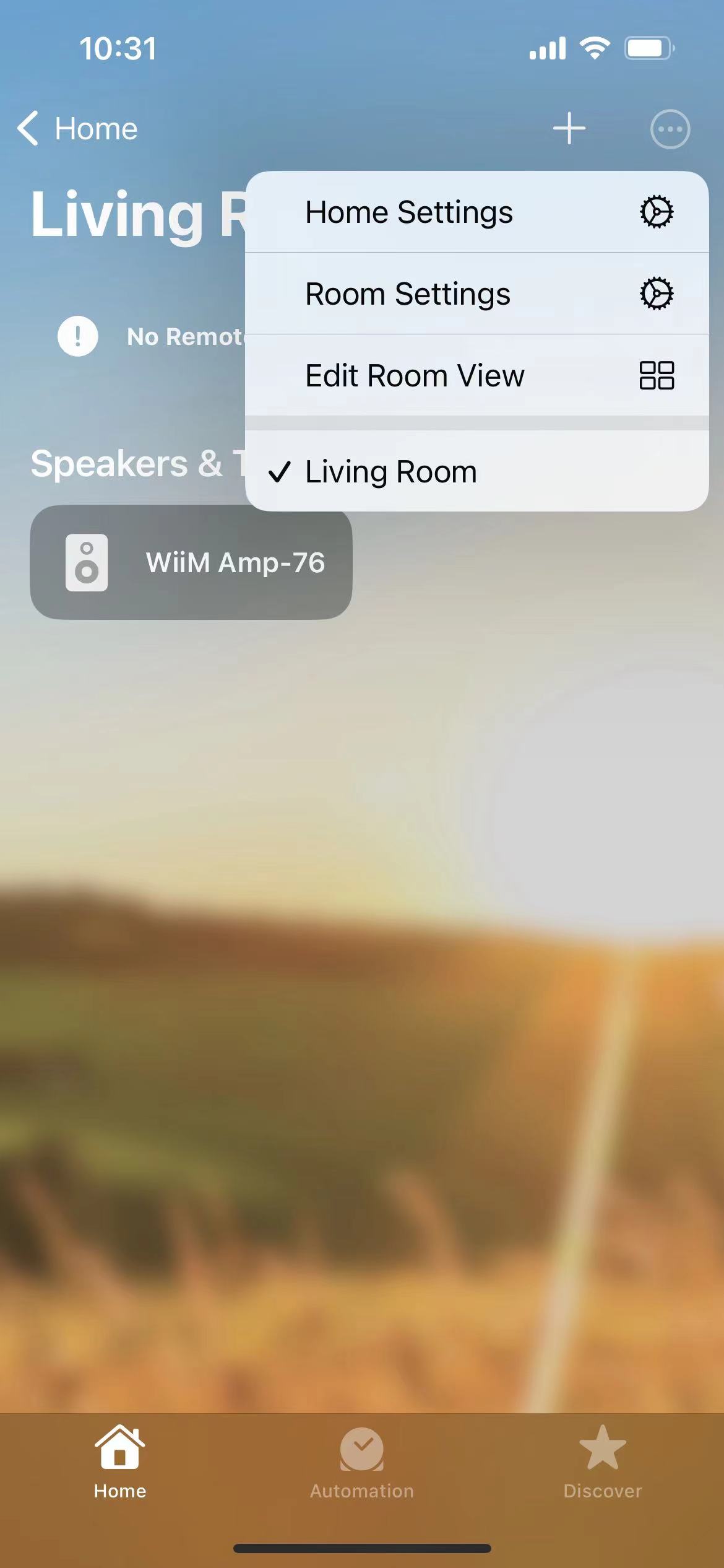

- Tap the
icon in the top-right corner, then select Home Settings.

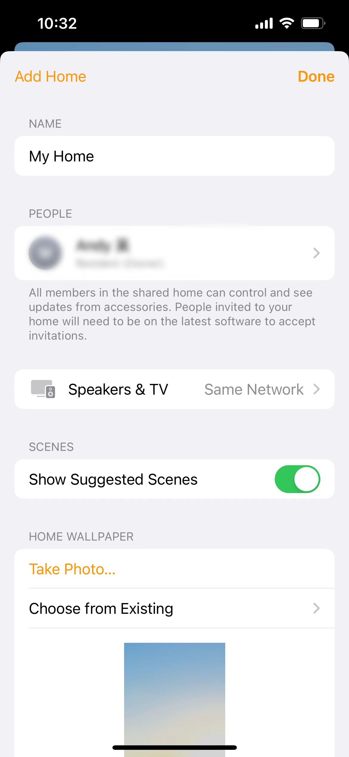

- Select Speakers & TV.

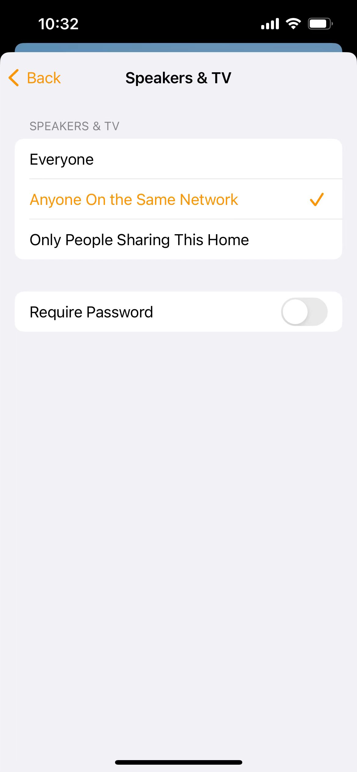

- Choose either Everyone or Anyone On the Same Network.
- Toggle on Require Password. A password is automatically generated. You can use this or set a password yourself.
Now, if someone on the same network uses a different mobile device to stream music via AirPlay to your WiiM device, they will be prompted to enter the AirPlay code (password).
