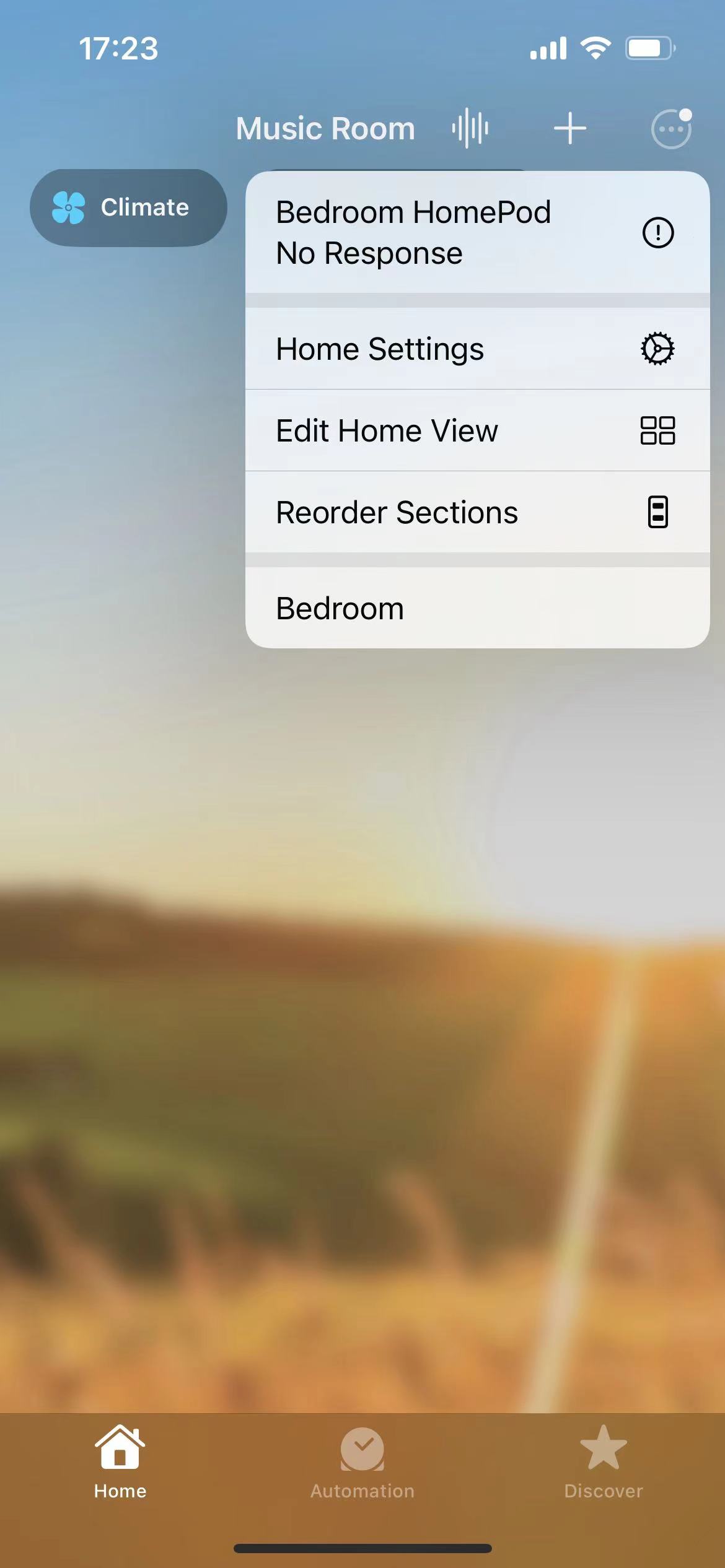

- If the issue persists, modify Apple Home settings and retry:
- Open Apple Home.
- Tap More Options (...) in the top-right corner, and then select Home Settings from the menu.
- Navigate to Speakers & TV, then select Everyone.
- Try to add your WiiM device to Apple Home again.
Following these troubleshooting steps should help you resolve any issues when adding your WiiM device to Apple Home.
