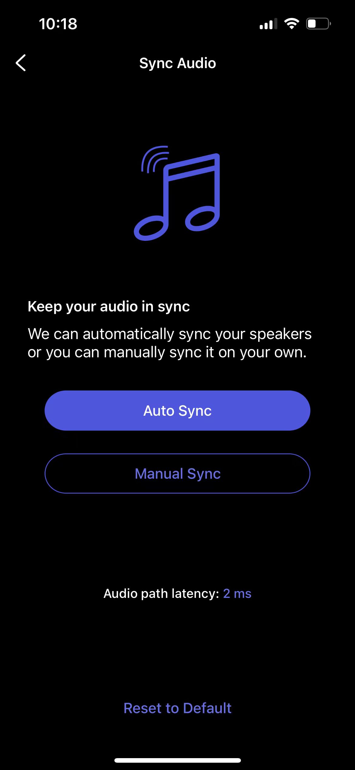

You can use the manual latency adjustment. On the WiiM home App, please select the device tab > tap the device setting gear icon > select sync audio > select manual latency adjustment and follow the instruction on the app to adjust.
